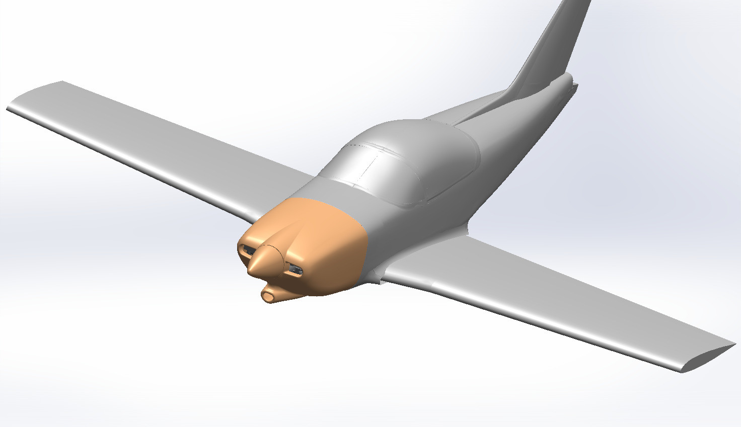

I found an Lycoming O-360-A2A. This type has a solid crankshaft, so it will become a fixed pitch instead of a constant speed propeller.
In between the busy work I'm working on the design of the cowling. Some pictures will follow.
Pas grand chose l'année dernière. Trop occupé avec le déménagement de l'entreprise et le démarrage d'une nouvelle production.
J'ai trouvé un Lycoming O-360-A2A. Ce type a un vilebrequin solide, il deviendra donc un pas fixe au lieu d'une hélice à vitesse constante.
Entre les travaux occupés, je travaille sur la conception du capot. Quelques photos suivront.

Bonjour AlexZ,
Which cowling is the nicest ?
I think that there is no correct answer as it is mostly subjective...
The top one would be called "classic" by some people and "old fashioned" by others.
A more interesting question, to my sense, is :
"Which cowling is the most efficient accordind to the use of the airplane ?"
If you want to fly strait to some destination, the bottom one, if properly designed would be more efficient (i.e would generate less cooling drag)
If you want to fly aerobatics, that means more often "high power - low speed", the bottom one would be much more difficult to design to avoid both overheating at low speed and overcooling while cuising...
To come back to aesthetic, I would say that paint (colours and drawing) may be as important as original shape.
I know that I didn't answer your question, but I think that a very "nice" but inefficient cowling woudn't be very satifactory.
Good flights

Well, I should have asked: Which design suits the CP1320 the most? The aircraft will be used mostly for cross country flying and sometimes a loop or roll.

Hi AlexZ,
First, I will remind you a little bit of the history of Claude Piel aircrafts :
When Claude Piel designed his single seater CP20 “Pinoccio”, that first flew in 1951, he intended to make an affordable sport plane looking like the Supermarine Spitfire…
He was asked to make a two-seater version of its CP20. And that two-seater version was the CP30 “Emeraude”.
The “Emeraude” was very popular and evolved into different versions (CP301 to CP1310/CP320), but also an aerobatic version called CP100, that was later renamed CAP10A, that is the origin of the CAP10B, CAP10BK and CAP10C aerobatic aircrafts.
But about twenty years after the first CP30, Claude Piel intended to create the successor of the “Emeraude”, including a strong structure inspired from the CP100, but with much up-to-date shape inspired from its last creation: the F1 Racer base CP80.
This successor of the “Emeraude” is the CP1320.
Even if the original cowling of CP1320, looks quite classic today, I am sure that was not the intention of Claude Piel.
To my sense, the second version of cowling suits much better to the CP1320 airframe than the first more “classic” one… and corresponds better to the intention of Claude Piel to make a fast modern-looking airplane.
As “the aircraft will be used mostly for cross country flying and sometimes a loop or roll” … there is no objection to this type of design.
Of course, this opinion is not necessarily the one of the other people on this site… but it definitely mine.

Philippe,
Thanks for your opinion. I'm aware of the history and we share the same view.
For the design I 3D scanned a Sam James cowling on a RV-7 and tried to follow the form. In the RV-7 the engine is positioned lower in the airframe, so had to adjust the shape a bit. I'll also use the air intake from James.

O hope you're well and still building. I would think either cowling would work so long as you use a plenum.

The idea is to go for the James cowl option and also copy the plenum.

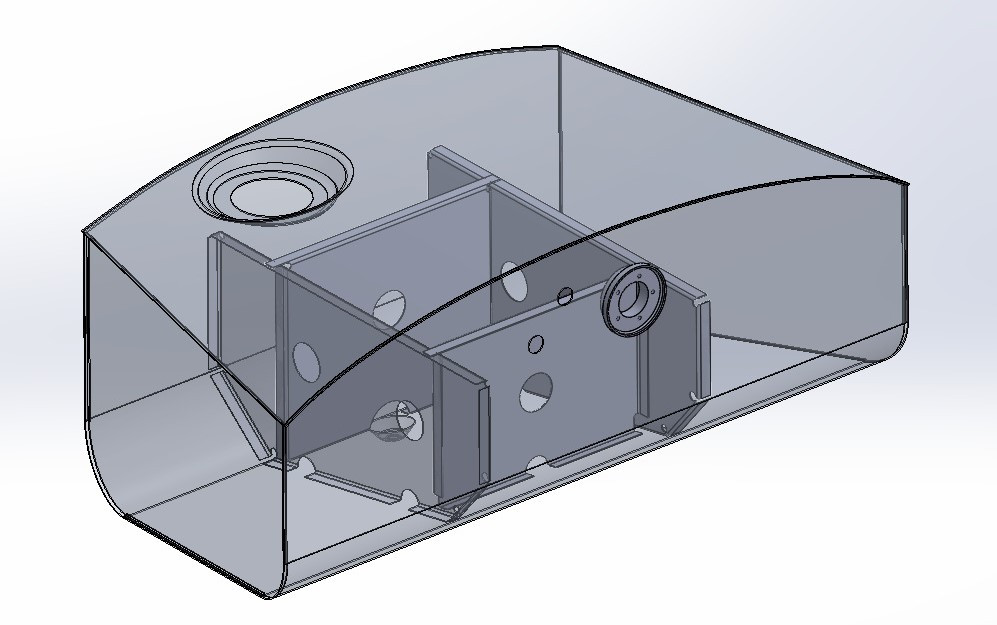

The design of the fuel tank is ready for cutting and welding.
La conception du réservoir de carburant est prête à être découpée et soudée.
